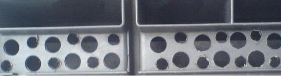

hmm.. too expensive! Takes only 15min to change the mains, I think I'll just try changing them when I'm up there. But how low can I go??? 145, 147? And do I have to do something more with the airbox? have borred alot of holes in it allready

sxr said:OK, guess I'm the only one here that can't afford an attac(450-500$ in norway)!!!But will it help if I gave it some more air( modding the airbox some more) Isn't the reason its so rich that the air is thinner at 1000moh??
If you do that, you're still going to have to change your jetting with altitude. More air will make your mixture leaner at low elevation.
