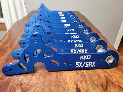

Not cheap but sure looks like the easy way to get center to center and belt deflection bang on.
www.krausekustomdesign.com
That's something I have not looked at at all, I definitely just plopped the engine in there last year once I got it together.
Yamaha SRX/SXR One Piece Clutch Alignment Tool | My Site
Billet aluminum one piece clutch alignment tool. Sets both center to center distance between clutches aswell as the offset for perfect belt alignment and cooler belt temps every time! Proudly designed and made in the U.S.A! Models also available for polaris,skidoo, and arctic cat.

Yeah I like a nice tool like that but I'd need to buy 4 more sleds to justify that. I marked center of the secondary bolt, back it almost all the way out, then used the center hole on the primary and measured between the two. Takes maybe 5 minutes. I couldn't get a spark plug to catch a thread at all.
Billet aluminum one piece clutch alignment tool. Sets both center to center distance between clutches aswell as the offset for perfect belt alignment and cooler belt temps every time! Proudly designed and made in the U.S.A! Models also available for polaris,skidoo, and arctic cat.www.krausekustomdesign.com
