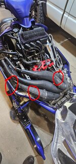

I don't have exact photos of it, but I marked up a photo of the sled to show the three general spots.Do you have pics of what melted? The SLP instructions were written at a time when the bar was apparently quite low for such a thing.
It was the clutch side pipe, near the shock mount, as well as the pipe near the mag side pipe where it rests on the heat taped area, and the silencer rubs on the side of the belly pan.
I found that if I lifted the pipe that is near the mag side shock mount that it brought everything more I to alignment, as the other two pipes rest on that lowest pipe. So I feel that a single heat shield there that lifts it will make the difference.
This is all off of memory from last winter so my recollection may not be perfect.

So here are a few photos, I made a shield out of aluminum with two layers of fire blanket for added insulation between the shield and the plastic.
You can see the spot by the right side upper shock mount that was getting the worst of the heat from the mag side pipe.
This seems to be enough, and was pretty quick to whip up with a metal blade on the circular saw, my vise and a dead blow.
