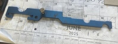

Another question, this alignment tool:
Or this one?
www.krausekustomdesign.com
Used one came with a Viper which ought to be the same, right? Looks a lot different than the Krause unit though. Do they all set the center to center distance and offset? How about getting the crank parallel with the jackshaft? Are some better than others at that?
Or this one?
Yamaha SRX/SXR One Piece Clutch Alignment Tool | My Site
Billet aluminum one piece clutch alignment tool. Sets both center to center distance between clutches aswell as the offset for perfect belt alignment and cooler belt temps every time! Proudly designed and made in the U.S.A! Models also available for polaris,skidoo, and arctic cat.

The Kraus alignment tool is the one I have that I have used on our SXs and the 700 SRX I had....works great.
