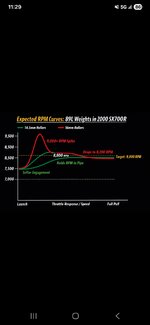

Just using ChatGPT to get some AI insight on my clutching and here's a graph in tossed together for me showing RPM curve change with the 89L weights and the different rollers. While I don't 100% agree with everything it says, it's definitely an excellent resource for troubleshooting. View attachment 68110
I'm not yet a fan of AI for this kind of stuff. All it does is google stuff and sometimes it can't even accurately repeat that, assuming what it found wasn't wrong in the first place. I really like using it to reword stuff.
